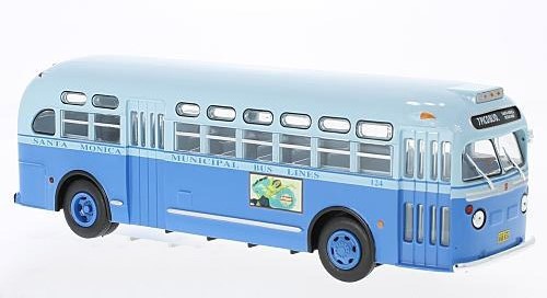

I found the following on the internet. They are under the name "IXO" and are listed as 1:43 scale die-cast models.
Can anyone give us the exact dimensions for these buses?
Any additional information is highly appreciated.
 Filesize:  81.32 KB
 Viewed:  90722 Time(s)
 Filesize:  47.23 KB

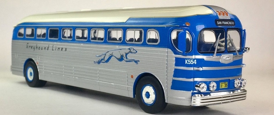

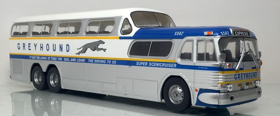

Two more models
 Filesize:  130.91 KB
 Viewed:  90721 Time(s)
 Filesize:  146.77 KB

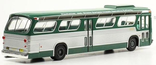

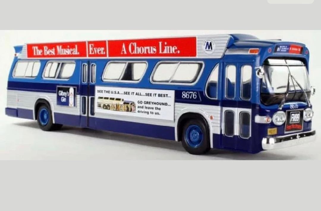

Here is another IXO GM "New Look" model, this time is a TDH-5301 ex, Fifth Avenue Coach in MaBSTOA service, number 3165.
I like that they included the roof-top radio blister
However, the engine compartment hatch lights are wrong.

PostPosted: Thu Nov 29, 2018 4:16 am    Post subject: Reply with quote
although it is better than corgi and busch it is still flawed in big ways, the rear window is not shaped right, the windshield is close but the glaring flaw for me is what manufacturers call the A pillar, the very front pillar to the roof on these are wider than on the real bus. I would have been happy to have these in 2000 but as Rapido Trains has made an almost perfect version I cannot go with this. I settled for corgis and buschs because I was desperate then. but with the bus being bigger it would kill me to look at the mistake. What many people do not see is how the driver's window is since it is close to the front which tapers so the front edge is not in line with the rest of the bus. Now another taper, the one where the bus tapers greatly at the top means that the window also is not perfectly vertical as the other windows are. The window leans in at the top. If you look at pictures of a fishbowl bus against the picture of a toy you will see this.
From the inside of the bus the windshield and driver's window overlaps. there is a very skinny pillar between the driver's window and the windshield.

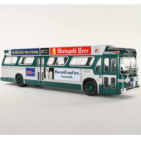

PostPosted: Mon Jun 03, 2019 8:45 pm    Post subject: Reply with quote
Look at what the New York City Transit Museum is offering for sale...
This is the same bus that IXO produced before, but now they have added the batwings.
Same flaws as before but this time they have added the mistake of a "TA" emblem with a MaBSTOA fleet number, 8456.
Price tag: $89.99

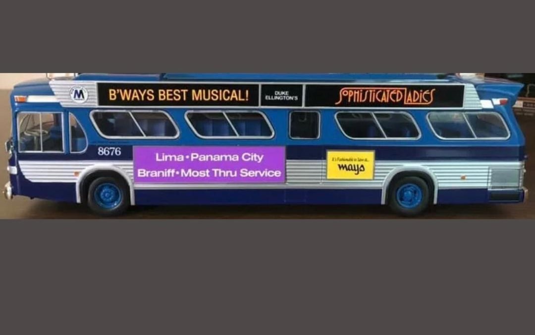

PostPosted: Thu Jun 06, 2019 10:41 pm    Post subject: Reply with quote
A two tone blue version is also available.
 Filesize:  120.87 KB
 Viewed:  88279 Time(s)
 Filesize:  96.54 KB

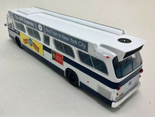

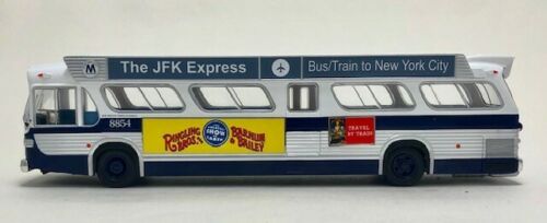

PostPosted: Sun Dec 29, 2019 9:15 pm    Post subject: Reply with quote

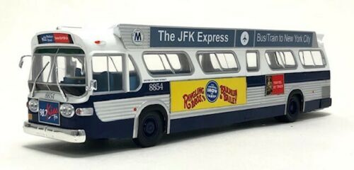

Iconic Replicas is introducing the third series of New York City "New Look" buses with batwings.
This time it is in the white and blue scheme.
They have changed the corner marker lights to the correct TDH-5303 bullet shape lights. However, they still have the emergency door. They did changed the window panes on the rear door to two instead of the four they used on the green version of this bus.
The only real problem is that fleet number 8854 was a T6H-5305A and not a TDH-5303!
Suggested retail price... $79.95
 Filesize:  29.49 KB
 Viewed:  86693 Time(s)
 Filesize:  19.95 KB

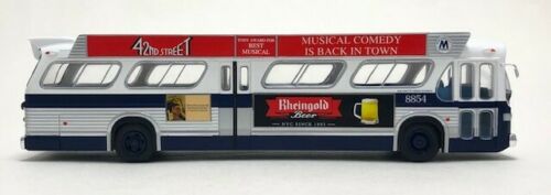

PostPosted: Sun Dec 29, 2019 9:16 pm    Post subject: Reply with quote
Here are three more views of this diecast model
 Filesize:  24.44 KB
 Viewed:  86690 Time(s)
 Filesize:  16.35 KB
 Viewed:  86692 Time(s)
 Filesize:  15.31 KB

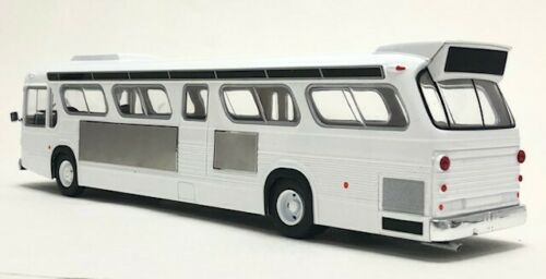

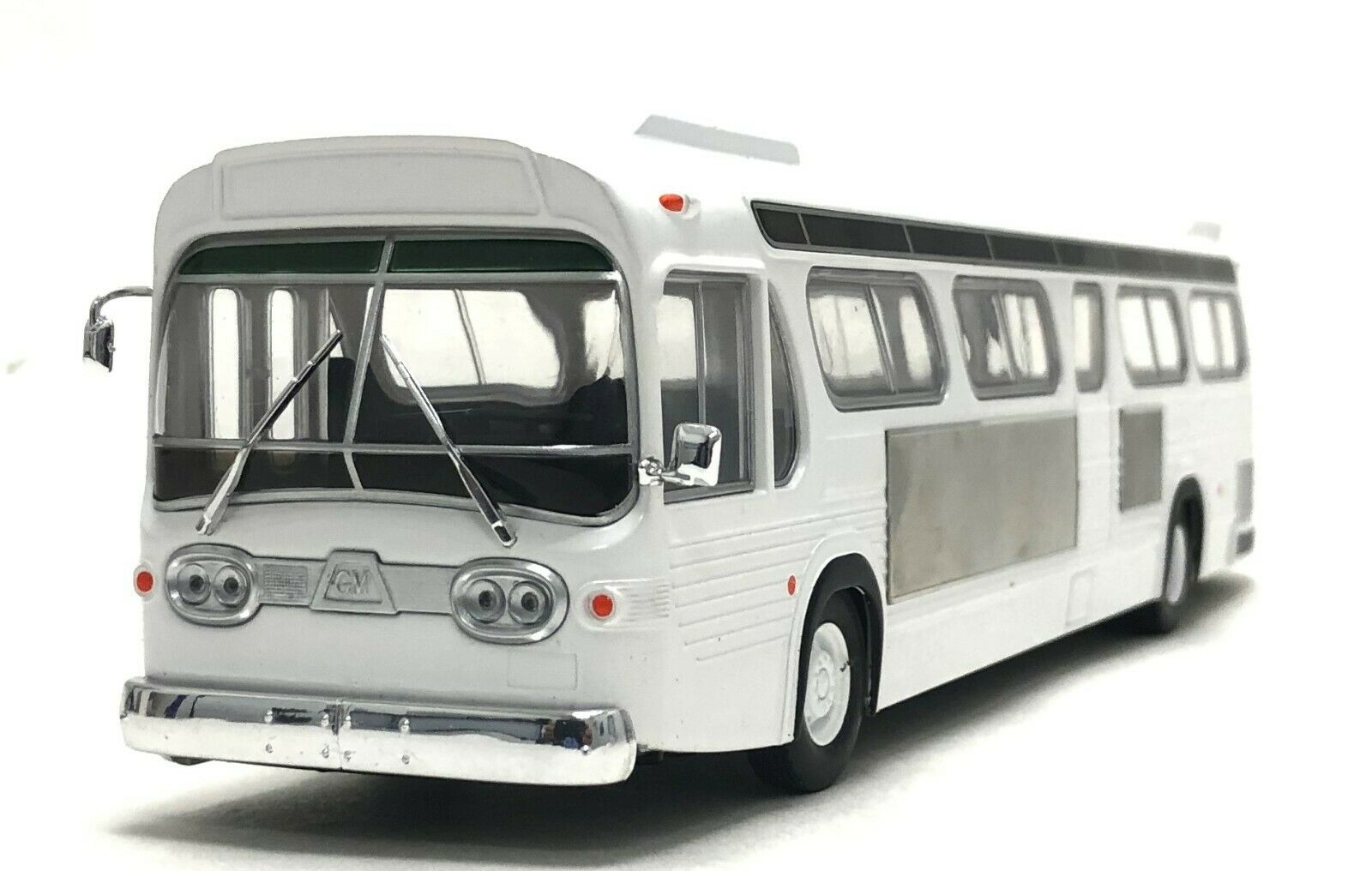

PostPosted: Sun Dec 29, 2019 9:21 pm    Post subject: Reply with quote

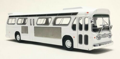

They are also releasing a non-decorated model TDH-5303 with air conditioning and a roof-top radio blister.
The standee windows should come to an end with the first window and not even with the quarter window.
