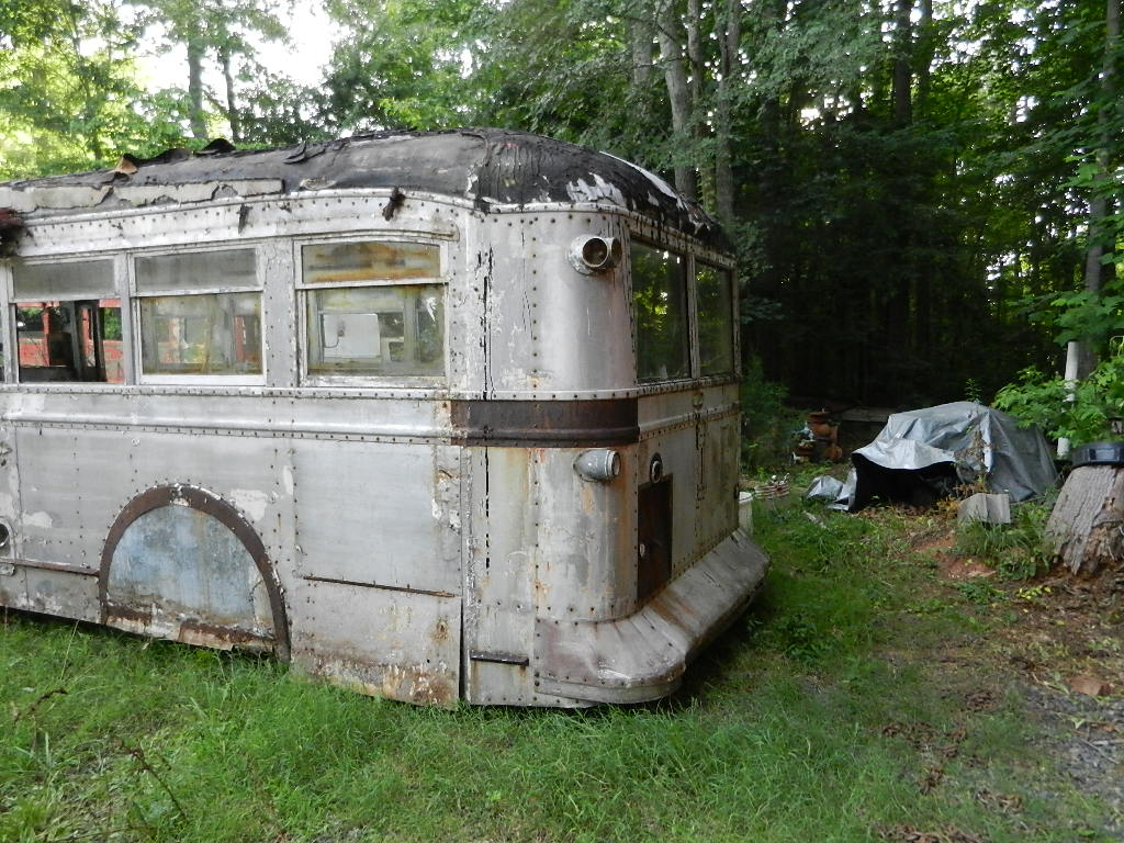

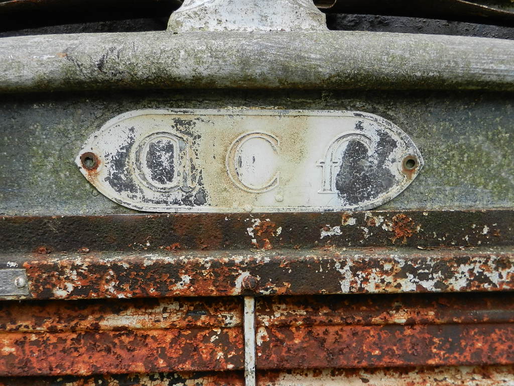

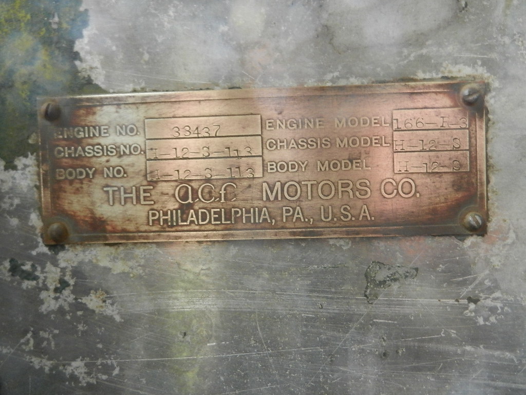

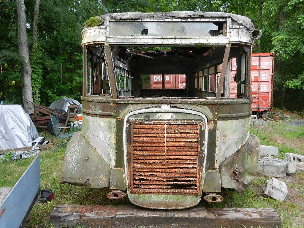

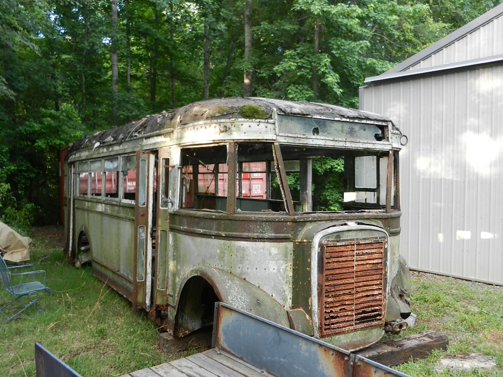

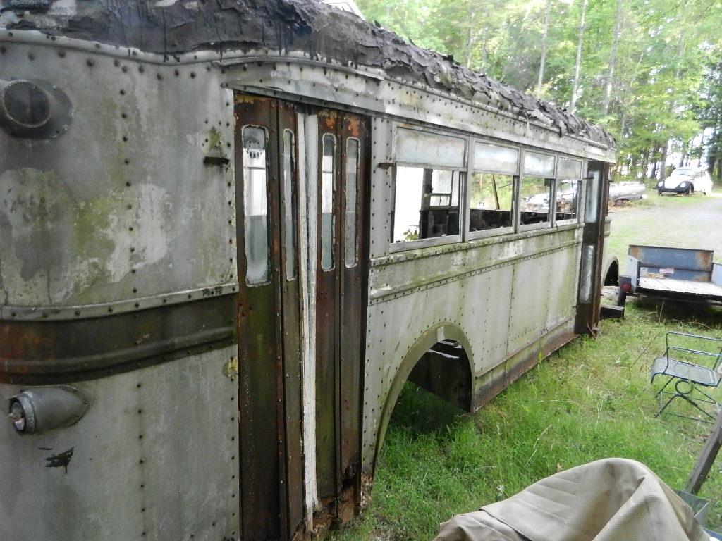

Attached are a few photos of the 1933? ACF H-12-S
There is no date on the data plate, unless the first two numbers in the engine number are the year it was made.

ACFCity,
There's certainly something to work with here but it's going to be a long haul!
I think that one of the most difficult restorations will be the roof which, in the era, was still steam bent plywood covered in 'traffic top' roofing on most buses.
Do you have any inkling as to where the bus originated from? - both New York City based Queens/Nassau Transit Lines and Staten Island Coach Company did use the model.
I can tell you that there's a fair chance that your H-12-S came from one of the two mentioned operators because they had numbers of them and only 49 were built in 1933 with only 242 manufactured altogether between 1933 and 1936.
When you're ready for it, just send me your Builder's Plate and I'll make it look like brand new for you in my work shop (no charge).

Mr. Linsky,
Thank you for your reply and photo.
The Roof should not be too difficult. The Model AA Delivery had a roof that was made of similar construction. The metal cross bows are all there and the longitutudinal wood strips are not too difficult to form because they are thin and narrow. There are enough of the wooden cross bows to make patterns and the wood on the very front and the very rear at the roof radius is all in tact. All of the interior white frosted dome lights are in excellent condition and I have all of the exterior light lenses and one of the tail light lenses. The tail light lens screws onto the housing. The glass lens has threads that are part of the glass lens. It was able to be removed with a lot of patience and penetrating oil. All of the running light lenses are red glass with the exception of the two top front facing lenses that are amber. The front door entrance step light and lens is still there and the WATCH YOUR STEP plate is still on the bus. The ACF name plate came with the Bus as well.
It will be a lengthy project, but will eventually be worth the effort. The frame under the body is in very good condition and the entire rear bumper is in excellent condition.

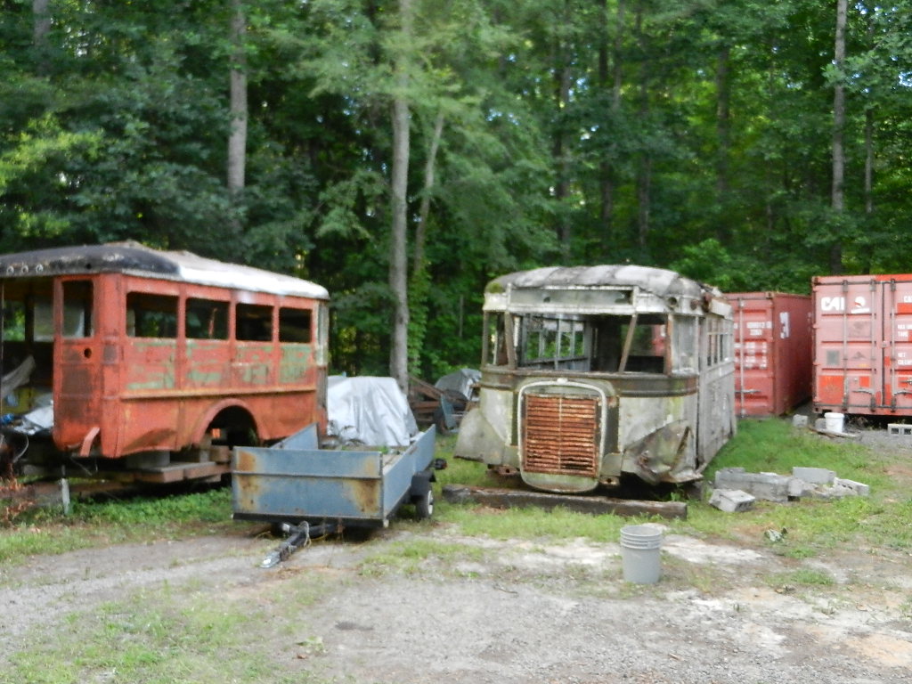

Mr. Linsky,
THANKS!!! Those are great photos you attached.
My bus was found about 20 miles south of Columbia, S.C.
Do you know if there are any records of the bus fleet in Columbia or Charleston, S.C. that used ACF H-12-S busses.
I found a 1932 ACF ad and this bus looks exactly like the one in the ad.
I'll get it scanned and see if it can be posted here.
The red bus body is a 1930 Wayne School bus body for the 121" wheelbase Model AA Ford or Chevrolet chassis.

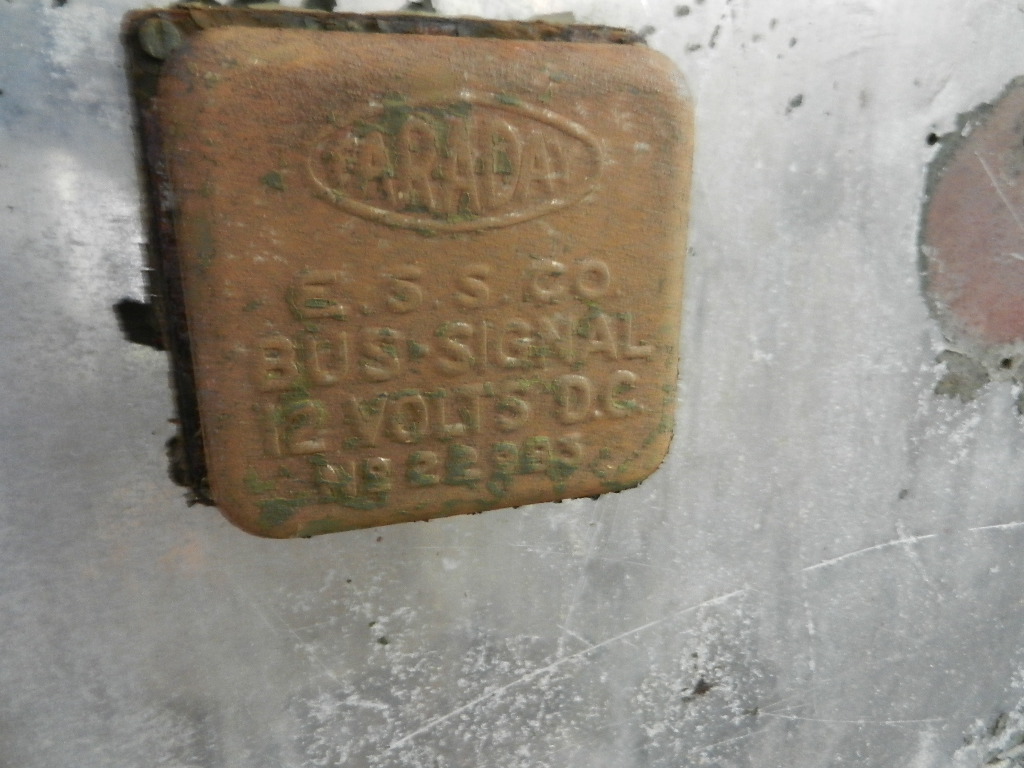

BTW; Yellow/GM used Faraday Buzzer systems both for passenger signals and mechanical warning conditions.

I have an ACF delivery list which shows that the bus is a 1934 model that was manufactured for Columbia Railway, Gas and Electric Company in Columbia, S.C. as their 43.
